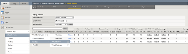

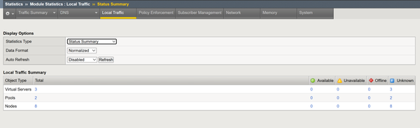

    Statistics > Module Statistics > Local Traffic >> Status Summary.
    2- After Upgrade , Open the same page and make sure that all Objects numbers ( VSs , Pools , Nodes )  are same as the first snapshot, and keep your eyes on the status as well and the numbers below it.
    Note: in some case you may need to wait a while until big3d service to run to allow BIGIP to monitor ( pool members ) it should take a while After Upgrade.
    Also you can verify these stats with the  Active unit ( Most properly you have HA Pair of Guests , you upgraded the Standby unit and before Failing over to the newly upgraded one you need to validate these stats between the older version device and the newly upgrade device.

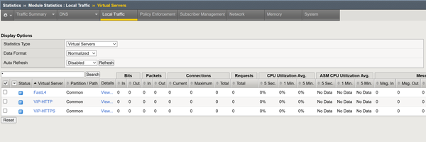

    3- After Failover, you need to check if your newly upgraded device receives traffic accross its Virtual servers , you can validate this from this snapshot:
    After failover you must see hits ( Bits, Packets, Connections, Requests ............ )
    If you didn't see any stats here, failback quickly >>> Don't wait ( there is an issue in traffic forwarding between the upstream Switch and your HA pair "GARP issues , Connectivities , Interfaces, SFPs .....etc " )
