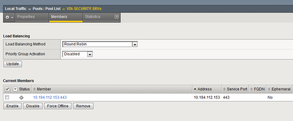

Pool member monitor color is grey

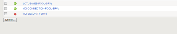

Hi to everyone, wondering if anyone has seen the health monitor color in grey, if they disable the node, by marking it offline or disable. Here´s the Big Ip info
Big IP Model 4000 Version 11.6 Build 6.0.442
I have used different browsers, and check if the behavior persist on the standby unit and it does, obviously the Vs won´t process traffic since the node is down. at least on that node.
My doubt is: Is grey a new color on the monitor check status or is it a cosmetic bug. Would appreciate an answer since I am preparing myself to the Tmos administration exam.
thanks in advance

  • Hi Vidar,
    the gray signs are indicating that the pool level status is green, but the parent (aka. at the node level) is marked down/offline.
    Gray circle = Available (Disabled Parent) - Pool member is available
    Gray diamond = Offline (Disabled Parent) - Parent down
    Cheers, Kai
