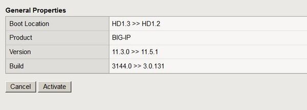

When I switch the boot location I can see the following:
I'm missing the row "install configuration --> yes/no" - Rene_Bader_1308
Altostratus
Nope. No dialog after pressing "Activate".

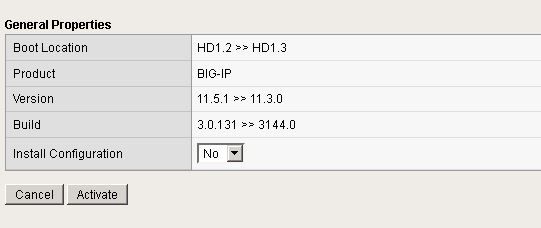

Funny thing is, when I switch back to the old image 11.3, I can select to install the config.- JRahm
