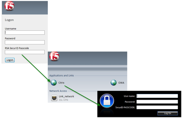

We have a webtop and we present the users with some webtop links one of the webtop links is our Citrix webpage. Can we pass credentials to the webtop link after you authenticate first from a webtop?

I'm no longer a Citrix administrator at my new job so I can't remember the steps off the top of my head nor can I show you the config we used, but I do know we did pass credentials through APM to Citrix so users wouldn't have to login. The way Citrix Web Interface was setup it wouldn't except anything but basic authentication, we had to adjust that and then we were able to pass credentials.
So the short answer is yes, it is definitely possible with APM. =)

I found the answer. What I was looking for is APM Portal Access and using SSO.
