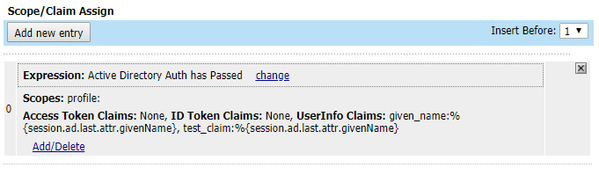

    This is what I had to do to get it working:
    • create a scope named
      profile
    • add scope OAuth Authorization agent in the VPE
    The
    given_name
    claim is now also shown in the
    session.assigned.oauth.authz.userinfo.claim_data
    session variable. See below.
    May  2 12:51:20 nielsvs-bigip info apmd[14875]: 01490007:6: /Common/ap_oauth_openid_connect_authorization_server:Common:a78f6aa7: Session variable 'session.assigned.oauth.authz.userinfo.claim.given_name' set to 'Niels'
    May  2 12:51:20 nielsvs-bigip info apmd[14875]: 01490007:6: /Common/ap_oauth_openid_connect_authorization_server:Common:a78f6aa7: Session variable 'session.assigned.oauth.authz.userinfo.claim.test_claim' set to 'Niels'
    May  2 12:51:20 nielsvs-bigip info apmd[14875]: 01490007:6: /Common/ap_oauth_openid_connect_authorization_server:Common:a78f6aa7: Session variable 'session.assigned.oauth.authz.userinfo.claim_data' set to '"given_name": "Niels", "test_claim": "Niels"'
    May  2 12:51:20 nielsvs-bigip info apmd[14875]: 01490007:6: /Common/ap_oauth_openid_connect_authorization_server:Common:a78f6aa7: Session variable 'session.assigned.oauth.authz.userinfo.claims' set to 'given_name test_claim'
