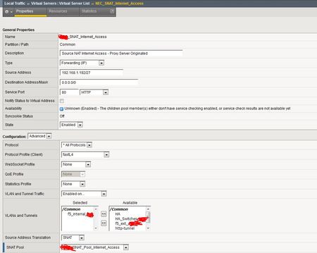

NAT for Internal Servers for Internet Access - Default Route
How the device learn the default gateway should not be a problem. I am assuming you are not using route domains.
How the servers query DNS stuff? You are only doing port 80, so this virtual server will not pass DNS.
Can you take a packet capture and check what is happening? Basically, we need to understand if the traffic is reaching the F5, and if yes, where is stopping.
