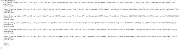

IRULE redirection to maintenance pool based on client IP and cookie...
Hi,
I have a requirement to redirect test clients to a maintenance pool based on client IP address and the client manually inserting a cookie. The process will be..
Server maintenance flag set which takes server out of the live pool and enables it in the maintenance pool. The a test client will set a cookie in browser and get redirected to the active server in the maintenance pool.
I have all this working with the IRULE below (there are actually more sites). However I am wondering if there is a more efficient way to do this (i am fairly new to IRULES)..
Thanks Matt

      Only if the True-Client-IP equals the data class AND the cookie exists will it select the maintenance pool. Otherwise it will process the next section routing traffic as normal. If the header does not exist it will simply return "" which should not match anything in the data class.
    • matt1985_299432's avatar
      matt1985_299432
      Hi Kevin,
      That works much better certainly if I set client IP AND cookie as specified it still gets me to the maintenance pools. However not falling through to the normal pools when there is no specific cookie client IP required.. just trying to work that through
      Thanks
