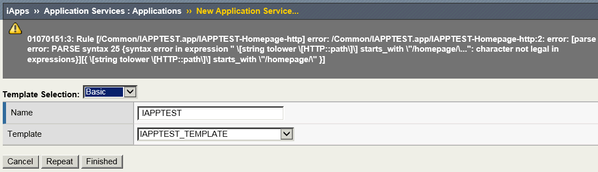

Gents,
Armed with this how-to article on DevCentral, I built an iApp template to automate app creation. However, the template only deploys properly when the iRule section is omitted otherwise it will throw this error:
01070151:3: Rule [/Common/IAPPTEST-irule.app/IAPPTEST-Homepage-http] error: /Common/IAPPTEST-irule.app/IAPPTEST-Homepage-http:2: error: [parse error: PARSE syntax 25 {syntax error in expression " \[string tolower \[HTTP::path\]\] starts_with \"/homepage/\...": character not legal in expressions}][{ \[string tolower \[HTTP::path\]\] starts_with \"/homepage/\" }]
This is the iRule portion that's breaking the template:

Anything wrong with the syntax? I'm happy to provide the whole template code if that's helpful. Device info: LTM, 12.1.2
  • Was able to get help from Support. The solution, contrary to the article, was to remove the backslashes so it should be:
        tmsh::create {
        ltm rule IAPPTEST-Homepage-http
        when HTTP_REQUEST {
        if { [string tolower [HTTP::path]] starts_with "/homepage"}{
         pool IAPPTEST-ebiz-http member 10.1.10.101
         } else {
    As opposed to:
        tmsh::create {
            when HTTP_REQUEST {
        if { \[string tolower \[HTTP::path\]\] starts_with \"/homepage/\" } {
         } else {

  • Hi Jason - When replacing the {} with "" I receive this error:
    Original syntax:
        tmsh::create {
            when HTTP_REQUEST {
         } else {
    Suggested change:
        tmsh::create "
            when HTTP_REQUEST {
         } else {
    Any other suggestions?
        tmsh::create {
        when HTTP_REQUEST {
         } else {
    As opposed to:
        tmsh::create {
            when HTTP_REQUEST {
         } else {
