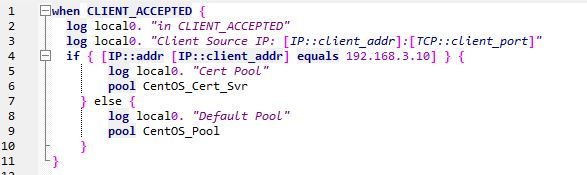

Newbie to F5 and iRules so apologies if my questions seem too simple. Thank you in advance for your time and help. I skipped the traditional "Hello World" first program to try my hand at an iRule that will soon be needed in our environment. I need an iRule that consistently selects a server pool based on the source IP address of the client. I've tried the code below and although my first hit from source 192.168.3.10 gets me to the "CentOS_Cert_Svr" pool as desired, subsequent "Refresh" from the web browser brings me back to the default "CentOS_Pool". From what I read on "CLIENT_ACCEPTED", this iRule trigger only fires when the connection is created in the Big IP's connection table. I presume that the refresh uses that existing connection and thus does not go through the iRule again and gets sent to the default pool for that VS. Is this interpretation correct? I'm sure this could be solved by setting up persistence on the VS but I would not want the servers in the default pool to also be covered by the persistence settings. Is there a way to solve this using iRules only? Thanks.

There are a few way you can do what you are looking for. I am guessing you also have Oneconnect enabled, this causes each HTTP request to be evaluated and LB and not treated as a stream.
You can add a persist statement in the if statment this will only create a persist entry if the pool is CentOS_Cert_Svr like the code below
if { [IP::addr [IP::client_addr] equals 192.168.3.10] } { log local0. "Cert Pool" pool CentOS_Cert_Svr persist source_addr }You can also get around this by changing the Event to when HTTP_REQUEST this will fire on each request from the client. Either method should fix the issue.
