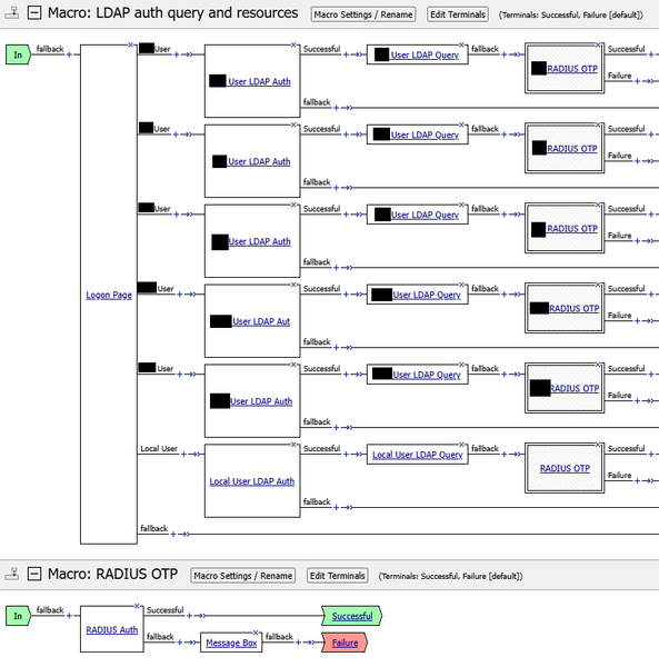

In Radius auth, how to allow second attempt of token input when the first input is incorrect?
How many Max logon attempts have you configured?
Try to set it to 1 in order to follow fallback branch after each failure and then handle retries with loop.
We have tried 1 and 5 times, but the problem is the RADIUS authentication does not enter the fallback/failure branch when authentication is unsuccessful, instead it returns back to the previous logon page. Any idea how to resolve this issue? Thanks!

I tried to reproduce it on a lab env and I had radius failure always following fallback branch
Do you might have a login page in the same macro?- felixkMar 24, 2025

Thanks for helping to test out in lab env! Please check the below image of our access policy, our radius authentication is in one marco and being called in another big marco where the login page resides. We even tried to make a message box in the fallback branch of the radius but it never goes there when the radius token is input incorrectly or in other ways.
- Apr 03, 2025
Do not getting even in message box is weird.
The only way is to check the logs but also set log level to debug before trying.
