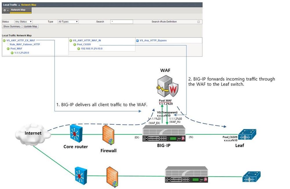

We are providing LTM service by configuring BIG-IP as below. (This is not a typical configuration)
BIG-IP creates two connections.
1) Client <--------------> BIG-IP <-------------> WAF
2) WAF <---------------> BIG-IP <-------------> Leaf
We are going to add http/2 configuration in these topologies.

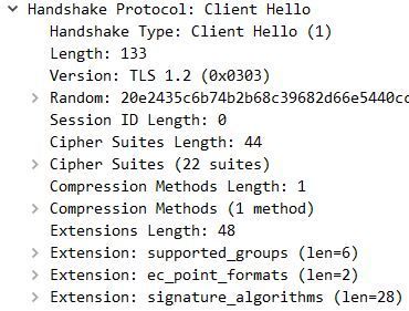

Client Hello for incoming traffic via WAF does not include ALPN.
From BIG-IP point of view, ALPN seems to be missing because Client is WAF.
In this case, even if I add http/2 profile, it is expected to fail due to topology issues.
Am I right in understanding?
Is there any other way to do http/2 successfully in this environment?
In this flow, the client is WAF.
Client Hello does not include ALPN because it is not a typical web browser.
Is it correct to not be able to use http/2 in an environment where ALPN is not included in Client Hello due to topology singularity?
Thanks.
I would say that you're correct. From what you describe, the WAF is acting as a reverse proxy. The limitation is on the WAF and not the BIG-IP.
If the WAF cannot proxy the ALPN extension, then you are going to have HTTP/1.1 on connection 2). I'm not sure if there is any way around this. Maybe the WAF software can be upgraded to support this? I'm assuming the WAF is different vendor hardware?
