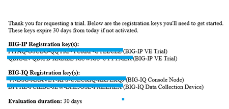

Hi
You can licence the trial version just the same as production version. Going through the following guides should hopefully help
https://support.f5.com/csp/article/K7752
You have 4 keys. The BIG-IP licences are so that you can deploy a HA pair if you like (or two seperate devices). The same goes for the BIG-IQ licences which is the management platform (should you wish to trial that also)
