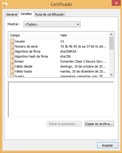

In this moment I have set up Chiper "EXPORT:DHE+AES-GCM:DHE+AES:DHE+3DES:AES-GCM+RSA:RSA+AES:RSA+3DES:ECDHE+AES-GCM:ECDHE+AES:ECDHE-RSA-DES-CBC3-SHA"
I try with different chipers but I don't solve this error. I added the imagen of certificate

Cipher's aren't the problem - the capture shows you're negotiating the "DES-CBC3-SHA" cipher, which is the F5's default for SSLv3 clients. RC4-SHA and RC4-MD5 are also options for SSLv3 if the client doesn't support 3DES.
Instead, the issue here is actually with your certificate. It's SHA-2 signed, and SSLv3 only knows about SHA-1 and MD5. You'll need to have the CA re-issue the certificate in SHA-1 format. Note that it won't be possible to get SHA-1 certificates starting in about 2016, so you'll need to upgrade your application to support TLS before then.
