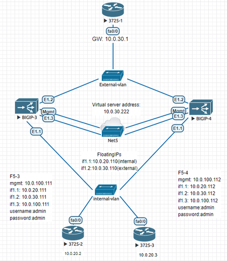

Hello, we have basic F5 config and diagram as below. When outside user 3725-1(10.0.30.1) ping the Virtual server 10.0.30.222, the half ping can be sucessful, and other ping is failed. In another word...

Mohamed_Ahmed_Kansoh , I checked the two nodes, and both should be Ok. but I found other virtual servers do not have the issue. So it is this virtual server that has the issue. so replacing it would be fine.

yes , if you have another virtual server works well , you can rebuild another new one with same configuration , it should work as expected.
