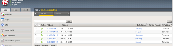

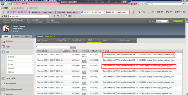

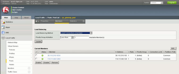

Hi I have two Data Center "1.64.0.6" and "1.65.1.20" , "1.64.0.6" display "can't find GATEWAY target member 114.113.234.233 for pool/Common/qs_gateway_pool"; In qs_gateway_pool can't find 114.113.234.233 with Date center "1.64.0.6" ,"114.113.234.233" is the self ip of "1.65.1.20"; All self ip can reach and green icon. I don't know why display the warning log in data center "1.64.0.6".

See this Solution Article: https://support.f5.com/kb/en-us/solutions/public/10000/300/sol10344.html
