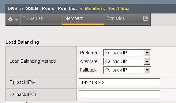

- Right now i have one GTM 11.5 with google DNS as primary DNS and BIND forwarding Server list as well. Also, i have created two wideIPs (test1.local & test2.local) because i want the GTM to answer directly with the following Ip Address, 192.168.3.3 and 192.168.4.4 (the ip address is not important, is just a record).
- So far i have been only able to configure both wideIPs to answer DNS queries and to reply with those IP address, but only if I configure assign pools that contains the testing ip address as fallbackIP and define the LB to "Fallback IP". This works but increase the response time by two seconds.

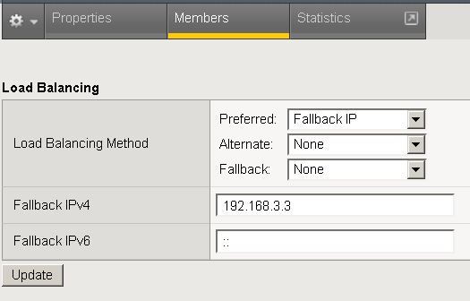

Regarding the DNS resolution of one (or many) local domain and objects it is quite simple. I only need to create the Listener (the one that will receive and accept DNS queries), create one wideip with the object we want to resolve and assign to it one pool that contains the ip address for the resolution. In my case i did not want to complicate things so i just use the fallback ip as record (Select as preferred Fallback and the rest as none)
