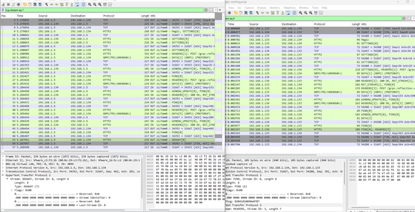

  • Similar to what you saw I am sending plaintext gRPC through mTLS tunnel between F5 BIG-IP and Linkerd mesh proxy and I see similar errors in the linkerd logs. Outside of using calico or cilium  and advertising service ip for the Nginx Ingress to that F5 BIG-IP is not in the path I see no other way.
    I see similar errors when I send traffic through F5 to plaintext grpc pod, so even decryption from what I see is not needed to see the issue where F5 just send GOWAY before the server response.
    Strange if I send traffic to 9001 from the F5 that gRPC with TLS I see no issues so for me the issue is with plaintext gRPC even when it is inside TLS tunnel (to an ingress) or MTLS tunnel (to linkerd enabled pod) . Interesting stuff.
    This tool can be used for testing plaIntext or insecure (tls)
    GitHub - fullstorydev/grpcurl: Like cURL, but for gRPC: Command-line tool for interacting with gRPC servers · GitHub
    grpcurl -insecure X.X.X.X:X list

    Right at the end F5 works like the direct connection but then sends GOAWAY.

  • hi Reqbaln ,
      I don't have experience with this setup, but have you taken a tcpdump on the BIG-IP to capture the transaction? You can enable some flags in tcpdump to allow for the tls keys to be included in the capture so it's easily decrypted in wireshark. I wrote a python script to actually take the capture, download it, and decrypt it for you for these situations.
    On the solution info, do you have a confirmed working monitor with the nginx ingress as a pool member, and do you get successful feedback when running this from the BIG-IP command line?
    nghttp -ynv https://<server_IP_address>:<port number>
