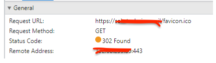

favicon.ico code 302
- Aug 09, 2023
Hi,
I solved the issue,
The java challnge in the Bot profile cause the problem
is ASM or your application issuing that 302? Not really an error, though, it's a redirect. Hard to tell from your image, but it looks like the actual favicon is a different URI path than what is being requested in the first image.
Hi JRahm,
Thank you for your reply,
you are right its code 302 which means some redirect, the problem is that I didnt find any redirect that related
I will continue to search one
Any idea if it could be something else other then redirect ?
- Rafi1Aug 07, 2023
Cirrus
I found that with FireFox It's the same code 302, but this browser shows the right favicons
Any Idea why I get this status code 302 ?
It must be some redirect that I missed or it could something else ?
When i bypass the bigip I get the right Favicons and no status code 302, only 200 ok- PauliusAug 09, 2023
MVP
Rafi1 When you are using developer tools in your browser what value are you seeing in the "Server:" field? Unless you have changed what the F5 inserts this should show something along the lines of "BIGIP" but if it's some other device issuing the redirect that server field value will be some other value not related to the F5.
- Rafi1Aug 09, 2023
Cirrus
Hi,
I solved the issue,
