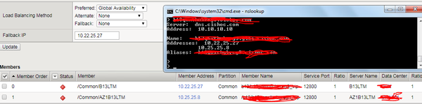

What i understanding regarding fall back IP is that if all virtual servers in pool associated with wide ip are down then DNS will resolve to fall back ip but in my scenario it's happening differently. I have included primary DC and DR virtual server/ip's in pool and fall back ip as Primary DC virtual server IP but when both virtual server are down then in nslookup it's showing both primary and DR VIP ip's instead of only primary DC IP in fall back IP.

  • Hello Suresh, Can you post a snapshot of your pool configuration .

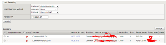

  • Hello suresh,
    This behavior is caused by using "Return to DNS" as a fallback method.Return to DNS drops the resolution to BIND. When this mode is used, the typical response will be a list of all virtual servers associated with the Wide IP.

      Thanks Kolom for quick reply, i will try by disabling return to dns option.
      Can you please help me to understand the below line from F5 site. "You can also use Return to DNS when you want to limit a pool in a single pool configuration to only one or two load balancing attempts"

      I have disable return to dns from fallback method but still its resolving both virtual server ip's in dns. What could be the issue?
