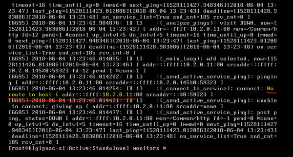

  • Dears, Many thanks for your answers. Is seems that a route is missing I can't ping the webservers (nodes) 10.2.0.11 and 10.2.0.33. Is it normal? see the log Besides when I do a telnet 10.2.0.11 80 I have the following answer "No route to host". In the configuration of BigIP I only declared the external route. Is it enough? thx
  • Hi,
    Verify the routing using tmsh show /net route.
    Then can you add a static route just for testing?
    10.2.0.11 to GW...
    Regards
