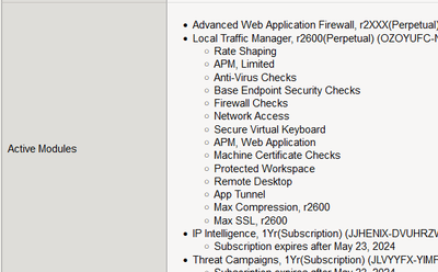

Sep 03, 2023As per the attached, Advanced WAF is licensed but the microservices tap is not found in the security tab.

In recent versions they've changed the location, it is under Security > Application Security > Security Policies > {Policy Name} > HTTP Message Protection > Microservices.
