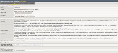

You Need To use iApp and configure it to not use apm. i have attched all my configuration.
Good Luck
Aviv
