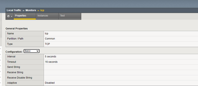

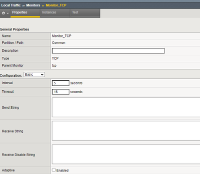

I am sending the Print of the configuration, we are using the Default and we created one, in both the problem happens.

Ok, yeah then you are right. What you see shouldn't happen.
As also requested before, what does the /var/log/ltm show about this monitor. Do you see it go up there or also not?
If not then it might be an issue between the BIG-IP and the server. Perhaps after the issue on the server the traffic gets lost. You would have to do a packetcapture on the server to determine that.
All in all it might be easier to create a support ticket, F5 support can help with this things on your actual system.
