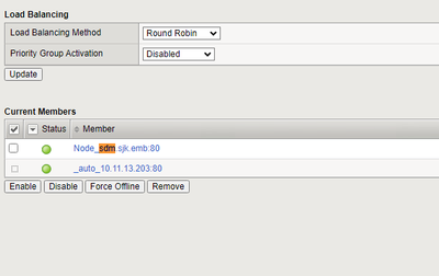

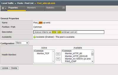

I have an application that is with the MONITOR (TCP) when there is an oscillation in the network, this monitor drops and does not come back when the application returns (I have to manually) make any change in the Monitor to force it to respond with status ok

The issue is that when the network presents instability and the monitor points as offline status, however the network works again and the Monitor status does not change automatically. like this was a bug or something.
because I have to go manually (change any parameter) inside the monitor for it to reprocess- boneyardJul 09, 2023
MVP
please add the configuration of the monitor itself, we need to see if you want changes to the defaults.
