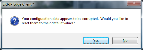

I have a couple users who seem to regularly get a popup indicating that their Edge Client Config is corrupt.
It's easy to say it is a computer problem since it is not widespread, however is there anything in particular that could be causing this?
Edge Client build 7101,2014,409,103
Thanks...

This could be due to corruption of C:\Users\AppData\Roaming\F5 Networks\VPN\client.f5c”
And it happens probably due to non proper shut down of the PC or the process.

i dealt with this issue for a few hours. Support articles had me deleting devices and having them reinstall, looking at netstat for conflicting port assignments.
Easy answer?
It's a corrupt config file
If you're on a AD managed laptop where the user profile in C:\Users is generated based on a set of rules:
Navigate to "C:\Users(username with the issue)\AppData\Roaming"
Delete ".\F5 Networks\VPN\client.f5c”
Restart.
Issue disappears.
