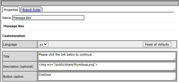

Try this:
Yes, there is another option. Add the image you want to display to the Webtop Hosted Content.
This image can be used in the MessageBox agent. You can add HTML to the description.

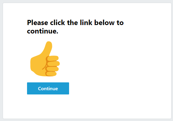

And here the result.
Excellent, I thought we might be able to use html code, but didn't try the description box. Thanks!

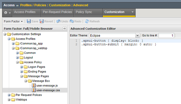

Now is it possible to center the "Continue" text. I've tried html and CSS code, also tried using the same img src=, I just get the text of whatever I enter.
- Nov 24, 2021
Try this:
- The-messengerNov 24, 2021
Cirrostratus
Thanks this got me what I need. And your reply in the other thread - didn't realize I had started 2 on this, thank you - helped also. It would be nice if we had more documentation, I'll ask my SE. But, good idea using developer mode to see the better context.
