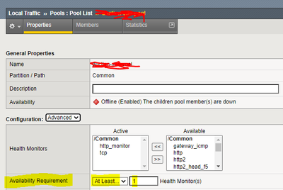

I found another solution, i have modified the properthies of my pool :

But I did not get you in my first reply , I concentrated to give you a solution for Logs and Traps.
in your scenario you have extend the availability to make the pool member up if one of two monitors go down , of course you will get a log when one of monitors goes down but your pool member will be still up and serving traffic as long as one of assigned monitors up and success in health monitors probs.
anyway , I am very happy that you have found your way to get ride of your issue.
