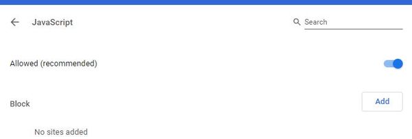

  • The CSRF protection inserts javascript. Is javascript enabled in the chrome browser? Check: chrome://settings/content/javascript
    If enabled, you can also open developer mode (F12) and take a look at the console. Maybe this will help you the find the cause of the problem. You can also use a tool like fiddler and make both a trace when accessing the site form IE and Chrome. Then compare those two traces.
