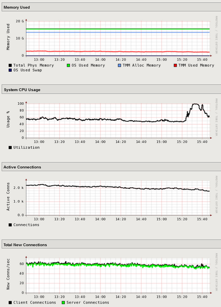

Supposedly AES-GCM should be the "best" cipher right now in terms of efficiency, however I noticed when enabling it on the F5, CPU goes up significantly. This is on a Viprion 2100 blade, 11.5.1 HF6. Anyone else seeing this?
I'm using "MEDIUM:!ADH:!RC4:@SPEED:RSA+3DES" for the cipher string. Adding a "!AES-GCM" to the line causes the CPU to immediately drop.

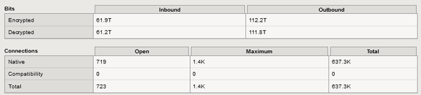

I'm using "MEDIUM" with a couple tweaks and all those ciphers, including anything AES-GCM, should be native. The statistics do confirm this:
We've had some issues in the past with the SSL acceleration on the Viprion 2100 blades, so I'm suspecting it's a performance bug.

We upgraded to v11.6.0 recently and had some serious issues, and had to downgrade to v11.5.1 briefly. I am now glad we stuck to v11.6.0, for our workload is much higher than is shown in your graph, but there is no problem with CPU usage, although there is some major behaviour change in comparison with v11.3.0 we upgraded from. - nitass
