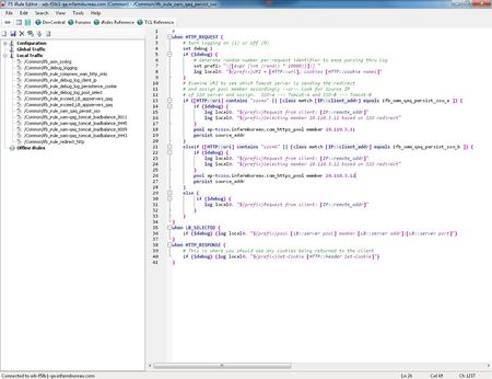

Apr 14, 2014cookie persistence not working in iRule
I have the below Irule which sets cookie persistence on a specific HTTP request based on a field in the URI and then again on LB Select (didn't think it was needed but it's not working :-)) But when...

Apr 15, 2014Thanks. That was very helpful. There was already a cookie persistence set on the virtual but I think it was the oneconnect profile that did the trick. Also, very slick the random number prefix - makes sifting through the logs much easier. VERY much appreciated!
