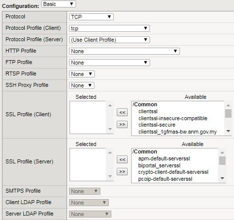

currently i encounter"Connection error: ssl_passthru:3994: not SSL (40) " and try to investigate the cause of this error. is there anywhere to check the detail of this error?. or anything to i miss in configure part at virtual server configuration part? refer to below for error when i run 'show / sys log ltm'

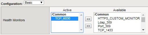

Which health monitor are you running? I see that it goes down, and I'm not certain that it is the forward of traffic that actually fails. You could always try to change it to tcp_half_open (temporarily) to see if this removes the error messages and if the application works as intended afterwards.
- zarev_316815
hi heinrichm, Health monitor i use as below to monitor pool with port 6030.
Could you share the configuration of the monitor? If it is just trying to complete the TCP handshake you'll probably have to go with Leonardo's answer.
