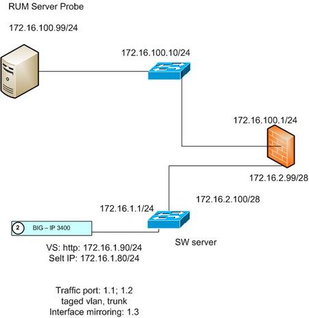

My network topology as blow. I read in F5 KB about configure interface mirroring as below:
link text
But I has some question:
- don't config IP for interface destination?
- from server want to g...

Aug 13, 2014A mirroring (destination) interface will have frame sent out with the original l2/l3 headers, so there needs to be a probe interface in promiscuous mode connected to it. You don't need an IP address on either the LTM interface or the probe interface. Your probe will have another interface which will have an IP (to allow access to the collected traffic from the RUM engine).
