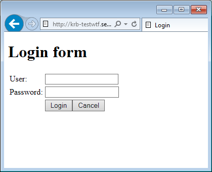

Hi, I'm trying to setup "client initiated form based SSO" in APM. I have a very simple test form but APM complains about that it isn't HTML in the response. I always get the error:
Sep 18 17:07:42 slot3/apstacc2-cl debug tmm2[20254]: 014d0536:7: /Common/allow_all:sc02_Appver:d156861a: Client initiated SSO non-HTML response received - Disabling response scan. sso config: /Common/test_formbased_sso, form: loginform
This is the very simple login form:
Can anyone explain why APM thinks that this form isn't an HTML form?

Hi,
I suggest you to check the html source code of the logon page.
According to the error "non-HTML response received", the logon page seems to be not well formated. By consequence F5 device can't parse the page to extract/fill automatically the input fields required for SSO.

Hi,
it's seems that response is non-html (response from the server), it would be Content-Type: "text/html". and instead you receive "application/pdf" (for example) .
It's due to your APP. So I advise you to use Developer Tools (F12) and capture traffic betwin your browser and the server (set your VS to L4 or attach the backend server directly).
It will allow you to see the response from the server when auth is done then to adjust your configuraiton.
keep me update.
