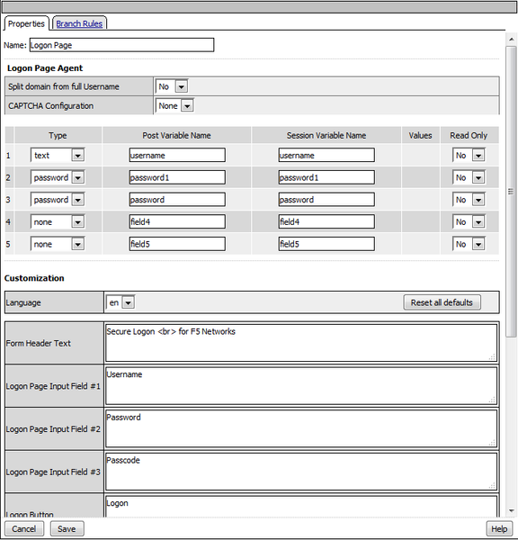

This is what my access policy looks like. There might be other stuff buried, but this is a start.
Under "Logon Page"

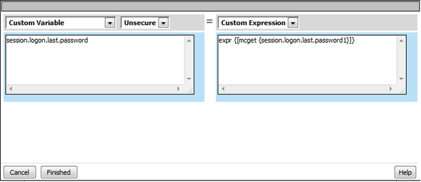

Under "Variable Assign AD"

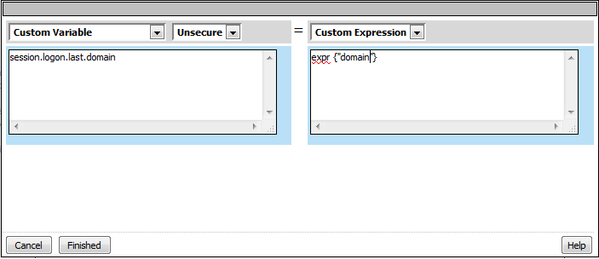

Under "Variable Assign Domain" (Enter your domain in "Domain")
