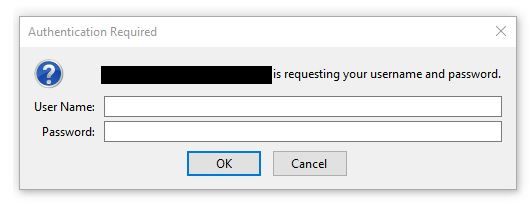

After building an ASM policy and going through the learning mode process, a Windows web application is having the login prompt blocked after changing the policy over to blocking mode. This behavior isn't producing a blocking page with a support ID.
Here is an example of the login prompt box:
If the policy is switched back to transparent mode, the login process is unaffected.

I guess that my main question for this would be, is there an area within the ASM policy that can be modified to allow the authentication prompt box to still pop-up and not be blocked?

Is your ASM policy blocking 401 response code? It should not by default: See https://support.f5.com/csp/article/K7922
If affected URL is a Login URL - have you configured it? See:
