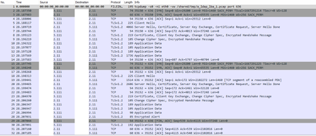

Hello, I'm not able to make remote authentication over LDAP work on Big-IQ. It works perfectly well (same accounts and LDAP servers used) on Big-IP. Please see troubleshooting results down below. It...
