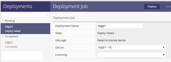

I've set up a License Pool (F5-BIG-VEP1-25M25V13) on my BIG-IQ 4.6 (Centralized Management), to provide LTM licensing to my new machines, which I'm deploying on vCloud.
So, what I'm doing is: 1 - I deploy the new LTM image on a vCloud VDC and configure it with a management address. This without using BIG-IQ. 2 - I discover that new LTM on BIG-IQ. 3 - I go to "License Device" using the license from the pool I've created before, but I get an error: Deploy failed, Failed to license device:

LTM versión 11.6.0. This is the error: [WARNING][2019][28 Jan 2016 17:46:26 UTC][RegKeyUpdater][checkedCompleted] Device 10.36.209.17 didn't have a registration key. [I][2061][28 Jan 2016 17:46:46 UTC][8100/cm/autodeploy/jobs JobsWorker][onPatchCompleted] Job 1afd4c70-dd66-473e-bb2d-ae11a47f313d started by user admin [I][2063][28 Jan 2016 17:46:46 UTC][LicenseTask][licenseDeviceFromGenericPool] Installing pool license grant to device '/mgmt/shared/resolver/device-groups/cm-autodeploy-group-manager-autodeployment/devices/0ae7e9b2-ef50-4e09-9e00-b34e11636dc5' using 'http://localhost:8100/cm/shared/licensing/pools/b876a3b7-1d6d-43a1-bee2-3b2575be6578/members' [WARNING][2069][28 Jan 2016 17:46:46 UTC][8100/cm/shared/licensing/pool-activation PoolLicenseActivationWorker][patchFailed] java.lang.IllegalArgumentException: Unparseable license format at com.f5.rest.workers.em.license.PoolLicenseUtils.makeLicenseBlob(PoolLicenseUtils.java:189) at com.f5.rest.workers.em.license.PoolLicenseUtils.createDeviceLicense(PoolLicenseUtils.java:129) at com.f5.rest.workers.em.license.PoolLicenseActivationWorker$7.completed(PoolLicenseActivationWorker.java:311) at com.f5.rest.workers.em.license.PoolLicenseActivationWorker$7.completed(PoolLicenseActivationWorker.java:300) at com.f5.rest.common.RestOperation.complete(RestOperation.java:1808) at com.f5.rest.common.ApacheAsyncRequestSender.handleRequestCompleted(ApacheAsyncRequestSender.java:147) at com.f5.rest.common.ApacheAsyncRequestSender$1.completed(ApacheAsyncRequestSender.java:91) at com.f5.rest.common.ApacheAsyncRequestSender$1.completed(ApacheAsyncRequestSender.java:87) at org.apache.http.concurrent.BasicFuture.completed(BasicFuture.java:119) at org.apache.http.impl.nio.client.DefaultClientExchangeHandlerImpl.responseCompleted(DefaultClientExchangeHandlerImpl.java:177) at org.apache.http.nio.protocol.HttpAsyncRequestExecutor.processResponse(HttpAsyncRequestExecutor.java:412) at org.apache.http.nio.protocol.HttpAsyncRequestExecutor.inputReady(HttpAsyncRequestExecutor.java:305) at org.apache.http.impl.nio.client.InternalRequestExecutor.inputReady(InternalRequestExecutor.java:83) at org.apache.http.impl.nio.DefaultNHttpClientConnection.consumeInput(DefaultNHttpClientConnection.java:267) at org.apache.http.impl.nio.client.InternalIODispatch.onInputReady(InternalIODispatch.java:81) at org.apache.http.impl.nio.client.InternalIODispatch.onInputReady(InternalIODispatch.java:39) at org.apache.http.impl.nio.reactor.AbstractIODispatch.inputReady(AbstractIODispatch.java:123) at org.apache.http.impl.nio.reactor.BaseIOReactor.readable(BaseIOReactor.java:164) at org.apache.http.impl.nio.reactor.AbstractIOReactor.processEvent(AbstractIOReactor.java:339) at org.apache.http.impl.nio.reactor.AbstractIOReactor.processEvents(AbstractIOReactor.java:317) at org.apache.http.impl.nio.reactor.AbstractIOReactor.execute(AbstractIOReactor.java:278) at org.apache.http.impl.nio.reactor.BaseIOReactor.execute(BaseIOReactor.java:106) at org.apache.http.impl.nio.reactor.AbstractMultiworkerIOReactor$Worker.run(AbstractMultiworkerIOReactor.java:590) at java.lang.Thread.run(Thread.java:745) When I discover the LTM device, I check the "update framework" item, so I guess it's up to date.
