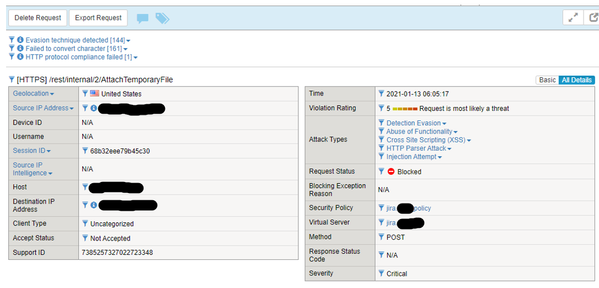

I'm fairly new to managing ASM and I'm learning on the fly. In this case, the protected application is a Jira instance. Most traffic that ASM has blocked for this application so far has been a single signature (For example, "Illedgal method" or "attack signature detected"). These blocks have a violation rating of 1 or 3. Today, a user tried to upload an attachment into Jira and ASM blocked it with a violation rating of 5. There is no button for me to "accept request" on this block. The number of signatures found for these blocks seems to vary depending on the type of file being uploaded (xlsx, docx, pdf) and varies between 85 and 242 signatures flagged.
I'm not sure what to do with this. How would you go about working through this? I hate to leave my question so open ended, but I just am not sure what to do with it.

      Thank you for the response. There are multiple violation types for a single event. The violation types are "Evasion technique detected", Failed to convert character" and "HTTP protocol compliance failed". The attack types listed are Detection Evasion, Abuse of Functionality, Cross Site Scripting (XSS), HTTP Parser Attack and Injection Attempt.
      No mention of illegal file type.

  • No worries. Can you go to Security >> Event Logs : Application : Requests and see if there are any entries? If you are logging illegal requests only (the default) you should see at least one blocked request--it's a red icon that is really obvious. You can select that offending request and figure out exactly why it was blocked.
    • Scott123456789's avatar
      Scott123456789
      Icon for Cirrus rankCirrus
      yeah, that's where I go. The image I posted above is part of the blocked event.

  • OK, let's back up for a second. Are there any entries on the Traffic Learning page? If not, it's because the "Learn" checkbox is not selected (for each violation) on the learning and blocking settings page. Try clearing the request log and recreating the event which caused the block. Most likely, the event that is causing it is a false positive violation--legit traffic that is getting blocked. It's unlikely that 144 evasion techniques and 161 instances of character conversion failures are real attacks all coming from the same request.
    The three violation types you show don't immediately seem related to file upload, so let's focus on those first. Worst case, you can uncheck the "block" checkbox for each one (Security >> Application Security : Policy Building : Learning and Blocking Settings) which will allow traffic to pass until you nail down the cause.

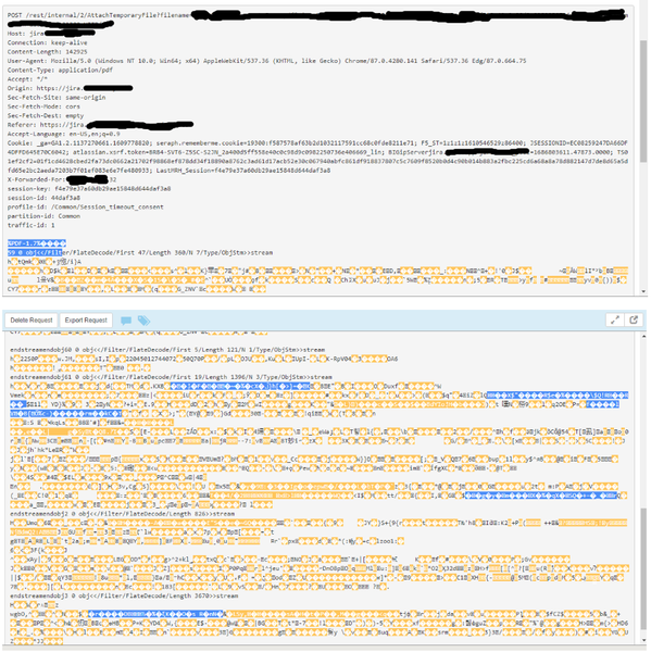

  • Can you post a screenshot of the blocked request? My guess is that it's not because of attack signatures--because you turned off the block flag (checkbox) and the signatures are most likely in staging unless you enforced them previously.
  • Directly below that section, can you view the decoded request? Is this the result of a request you know is legal?
  • @A few things to verify:
    1. This is an HTTPS request. Make sure you are decrypting the request at the virtual server before ASM processes it. Do you have a server-side SSL profile? The example above looks like it isn't being decoded correctly.
    2. With regard to decoding, verify that the application language for the policy is the same as used by the application.
    3. Try adding the URL to the Allowed URLS list. Then you can disable attack signatures and control methods on that specific URL.
    In your first example, can you determine exactly what the HTTP RFC compliance violation was? Also, if this traffic is internal and/or trusted, you could try adding IP address exceptions to bypass ASM entirely.

      If it was an SSL decryption issue, wouldn't I have more problems? On this same virtual server/ASM policy, I've had other blocks the last few weeks and been able to make exceptions easily. The button just isn't there now.
      I'm still confused why unchecking the "block" check boxes didn't work for me.
  • It should work. But that example sure looks like it isn't being decoded. You could try restarting the ASM daemon if it's permissible, but I would recommend getting support before doing that.
