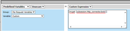

My problem is that i cannot get the data to variable in irule to first show the data in logs (log local0.) to be sure that I get the date i have this simple iRule
when ACCESS_PER_REQUEST_AGENT_EVENT {
set id [ACCESS::perflow get perflow.irule_agent_id]
if { $id eq "irule_agent_one" } {
log local0. "iRule agent $id PRP."
set log1 [ACCESS::perflow get subsession.http_connector.body ]
set log2 [ACCESS::perflow get subsession.http_connector.status ]
log local0. "Log1 $log1"
log local0. "Log2 $log2"
}But it shows error in ltm.log:
perflow variable name (subsession.http_connector.body) invalid (line 7) invoked from within "ACCESS::perflow get subsession.http_connector.body "and like i wrote before i have a subsession:
879cb369./Common/HTTPConnector/XXXXXXXXXXX==.nvp_block.subsession.http_connector.body
The variable perflow.irule_agent_id shows in the logs so in my opinion its not like the variable is for example not yet populated?

I noticed in the example from your LTM log message there may be a trailing space on the error:
Perhaps try modifying the iRule to use something like this, with the spaces removed.
set log1 [ACCESS::perflow get subsession.http_connector.body] set log2 [ACCESS::perflow get subsession.http_connector.status]
