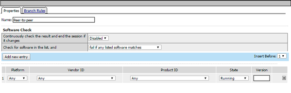

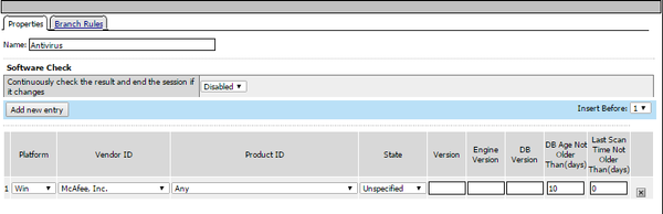

We have an issue with the Hostchecker that we have implemented in our APM. The Hostchecker we make is very simple:
Policy:
AV:
P2P:
Normally a user accesses and does not fail, but sometimes a user accesses and gives an AV or P2P error, then after giving an error he tries again and accesses normally.
They do not have outdated antivirus or some P2P program running.
The issue always happens with a Wi-Fi connection (corporate or not), never with an ethernet cable connection.

AV error:
/Common/Politica_PRODUCCION:Common:a2d41338: Session variable 'session.check_software.av.count' set to '0' /Common/Politica_PRODUCCION:Common:a2d41338: Session variable 'session.check_software.av.error' set to '2' /Common/Politica_PRODUCCION:Common:a2d41338: Session variable 'session.check_software.av.state' set to '0' /Common/Politica_PRODUCCION:Common:a2d41338: Session variable 'session.check_software.av.state' set to '0' [...] /Common/Politica_PRODUCCION:Common:a2d41338: Following rule 'fallback' from item 'Antivirus' to item 'Message Box' /Common/Politica_PRODUCCION:Common:a2d41338: Following rule 'Incorrecto' from item 'Chequeo PC' to ending 'Deny'
P2P error:
/Common/Politica_PRODUCCION:Common:570d9817: Session variable 'session.check_software.last.p2p.count' set to '0' /Common/Politica_PRODUCCION:Common:570d9817: Session variable 'session.check_software.last.p2p.error' set to '2' /Common/Politica_PRODUCCION:Common:570d9817: Session variable 'session.check_software.last.p2p.result' set to '0' /Common/Politica_PRODUCCION:Common:570d9817: Session variable 'session.check_software.last.p2p.state' set to '0' [...] /Common/Politica_PRODUCCION:Common:570d9817: Following rule 'fallback' from item 'P2P Activo' to terminalout 'Incorrecto' /Common/Politica_PRODUCCION:Common:570d9817: Following rule 'Incorrecto' from item 'Chequeo PC' to ending 'Deny'
