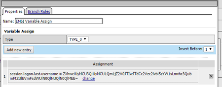

Working on an F5 running BIG-IP 11.5.4 and using a Variable Assignment that I have used on many other F5s as shown below.
session.logon.last.username = expr { [mcget {session.saml.last.nameIDVa...

Opened a support ticket and this ended up being an issue with the browser and the F5 admin page. Deleted all cookies, restarted the browser and entered the expression again and it no longer garbled the expression as it had previously. The expression is now working fine.

Apr 14, 2016I am using expr { [mcget {session.saml.last.nameIDValue}]} to grab the nameID out of the SAML response and set the session.logon.last.username variable with that value. I have used the same expression on other F5s not sure why I am running into an error hear or why when I go back to edit it, it appears as it does in the attached picture (above)
