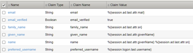

- Access > Federation > OAuth Authorization Server > Claim
- Created these claims to send values I wanted to send

- ID Token Claims: Add all Claims created to selected
- Note this will ensure these are sent when looking at decoded token values
- UserInfo Claims: Add all Claims created to selected
- Note this will ensure that these values are used to create ESRI Account

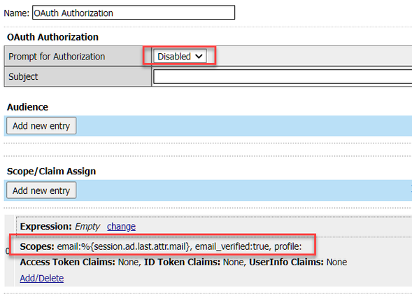

- Oauth Authorization
- I chose to disable Prompt for Authoriation to avoide customer from having to click authorize when logging in.
- Add scopes to this Agent
- Once complete add this access profile to the virtual server you created above

I got this working but the claims it is sending are not being populated on the ESRI side correctly and I am not sure why.
My main issue was my client ssl profile tied to my virtuial server didn't have a intermediate cert configured so was failing to send user profile.
In order for this to work I am using automatically create account on login which I see is setting the username to what looks like the openID unquie identifier.
Does anyone know how I can force this to username instead of this value?
From what I read username should be included in the profile scope but onlything that seems to be going by default is sub from openID scopes which is set to the value I have in the Oauth profile Subject (so for me it happens to be first and lastname)
I have tried creating email and username scopes and claims, which I can see get sent in the token but not able to populate needed values on the esri side.
Anythoughts?
