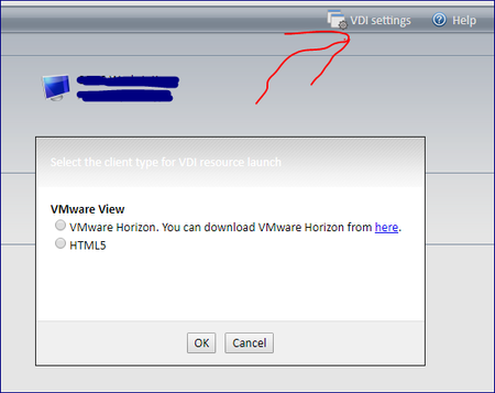

We had a similar issue and it seems 13.1.0.6 may have corrected it.
Hi Ryan, I just closed off a support case today with a similar issue for HTML5 Blast on BigIP 13.1
We also got HTML5 Blast working by changing the view.proxy_addr session variable, we actually deleted it entirely which again directs the Blast protocol to initiate to the FQDN name of the VIP (it keeps using the running browser session URL).
We are running "unsupported" versions (old View iApp 1.2, BigIP 13.1, Horizon 7.3.2) so I assumed our Blast issue was due to changes in how the iApp/BigIP VDI code interacts during the setup wizard. I haven't got to test a new deployment of 13.1 with iApp 1.5.3 yet.
