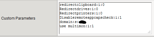

    • Adam_Willcox's avatar
      Adam_Willcox
      Sorry to bump such an old topic. But I just did this intuitively, it didn't work, and my first search of the forums hit on this post telling me to do exactly what I did! Am I missing something basic? It doesn't actually need the quotes does it?

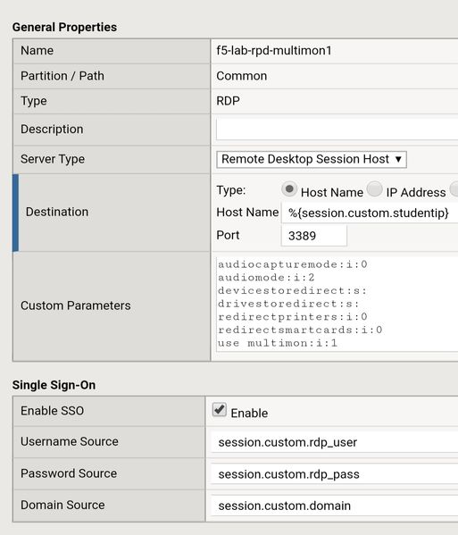

        Hey Adam,
        Looks indeed pretty good to me. What's the chance that one of the above parameters is causing trouble and the RDP client doesn't reach the multimon parameter when it parses the file? (e.g. the Disableremoteappcapscheck:i:1 could be wrong?) Not too sure about them, but maybe you can try putting the multimon parameter to the top of the Custom Parameters bit and see if that makes a difference? And/or temporarily removing a bunch of them and see if only the multimon-one works?
        See below the full configuration of my RDP object which get used daily, so still works ;)
