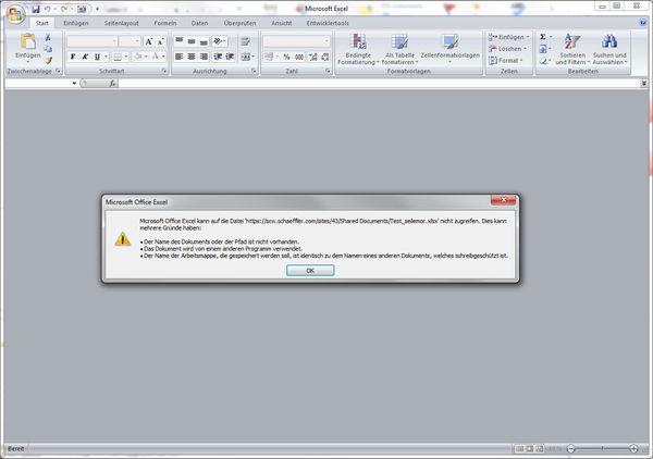

I´ve a problem and hope that you can help me. I've published a internal SharePoint via a iApp to external users. I´ve used the current iApp template and in the configuration I activated the usage of APM. If I test the connection now I must authenticate at the logon page and with the SSO ntlm setting I´m also authenticated at the sharepoint. I can create tasks and so on. The one thing which will not work is if I try to edit a document which is stored in the SharePoint. Excel show a error that it can not reach the document. If I deactivate APM in the iApp I can edit the documents without any error.
I´ve checked the setting for the "cookie persistance" and tried out to add the hostname to the trusted sites in the internet explorer. I also tried out to create a portal access. Nothing helped me... I think that there is a issue while the authentication from excel against the apm.

I think I´ve found my problem. It seems that APM can not work with WebDav. If I want to edit a document out of the SharePoint we can see in the APM log that the user handler is a Microsoft WebDav client. In the APM log we also see that there are regarding the WebDav communication unknown HTTP methods.
err apd[21063]: 01490000:3: HTTPParser.cpp func: "parseHttpRequestHeader()" line: 172 Msg: Unknown HTTP method: PROPFIND
It seems that APM will discard connections with unkown HTTP methods. After I´ve insert a iRule which will deactivate HTTP if the method is unknown I can edit the documents. The following iRule has helped me... https://devcentral.f5.com/wiki/irules.DisablingHTTPProcessingForUnrecognizedHTTPMethods.ashx
