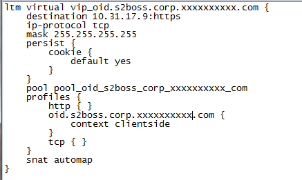

Okay, clearly not having a v10 system in front of me is slowing me down. Can you post a sample from the following command:
tmsh list /ltm virtual - willsweeper_131
- willsweeper_131
I couldn't get the format right, so I uploaded the image of 1 of the 1700 virtual servers.
