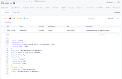

XC - Obelix table syncer list operation failed.... How can I check point?
Hi,
I installed CE in our vCenter.
I deployed 'certified Hardware' is 'vmware-regular-nic-voltmesh'.
I wanna inside network connect to global network.
The internal interface network is not allocated and an error message is displayed.
How can I next action?
I can't find the this issues...

As this could be related to the new CE Site Availability feature maybe redeploy the CE as if it did not upgrade successfully maybe it can't support this. Also check if something is blocked between the CE and RE like the domains that should be allowed and ports as something could have been added.
https://docs.cloud.f5.com/docs/reference/network-cloud-ref
If you have not upgraded maybe before the redeploy option try that:
https://docs.cloud.f5.com/docs/how-to/fleets-vsites/upgrade-fleet
