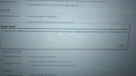

3 TopicsVirtual Wire configuration is not imported properly by BIG-IQ
Hi, I am facing the following error when I try to import a Virtual Wire enable BIG-IP device into BIG-IQ: java.lang.IllegalArgumentException: tag 4096 must be between 1 and 4094 I know that issue related to VLAN Groups that requires the allowVlanGroup directive in restjavad.properties.json. Is there something similar to enable Virtual Wires? Thanks!338Views0likes0CommentsVLAN-Groups Self IP Assignment vs. Supernet
