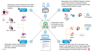

5 TopicsEnhance your GenAI chatbot with the power of Agentic RAG and F5 platform
Agentic RAG (Retrieval-Augmented Generation) enhances the capabilities of a GenAI chatbot by integrating dynamic knowledge retrieval into its conversational abilities, making it more context-aware and accurate. In this demo, I will demonstrate an autonomous decision-making GenAI chatbot utilizing Agentic RAG. I will explore what Agentic RAG is and why it's crucial in today's AI landscape. I will also discuss how organizations can leverage GPUaaS (GPU as a Service) or AI Factory providers to accelerate their AI strategy. F5 platform provides robust security features that protect sensitive data while ensuring high availability and performance. They optimize the chatbot by streamlining traffic management and reducing latency, ensuring smooth interactions even during high demand. This integration ensures the GenAI chatbot is not only smart but also reliable and secure for enterprise use.622Views2likes0CommentsWhat CLI tools are in your toolbox for testing or troubleshooting application deployments on BIG-IP?
