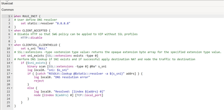

SNI (Server Name Indication) is an extension of the TLS protocol that is used by the client to indicate the hostname it is attempting to connect to at the start of the SSL handshake. In the case of the BIG-IP the SNI can be used to select which client SSL profile should be applied to the ingress traffic but it requires at least one client SSL profile to be attached to the virtual server. In other words the SSL data must still be decrypted. This iRule which is suitable for some SSLO use cases does not require SSL traffic to be terminated (i.e. decrypted) on the BIG-IP. It only needs a generic SSL persistence profile to be attached to the virtual server and this just to circumvent MCP validation issues. Once the CLIENTSSL_CLIENTHELLO iRule event is triggered, the SNI can then be determined and used to steer traffic. In this example below, once the SNI is found, an attempt is made to resolve it using DNS and then route the request using the BIG-IP to a gateway which could (in the case of SSLO) be a Secure Web Gateway device. Note SSL::extensions -type <extension type value> returns the opaque extension byte array corresponding to the specified extension type value, or an empty string if not found. Extension Type 0 is the server name. The "node" command is useful if you want to send traffic to a specific IP/port combination that is not defined as a pool member iRule [root@sslo:Active:Standalone] config # tmsh list ltm rule bluecoat ltm rule bluecoat { when RULE_INIT { set static::resolver "8.8.8.8" } when CLIENT_ACCEPTED { HTTP::disable } when CLIENTSSL_CLIENTHELLO { set s_sni "NULL" set sni_exists [SSL::extensions exists -type 0] if {$sni_exists} { binary scan [SSL::extensions -type 0] @9a* s_sni log local0. "sni: $s_sni" if { [catch "RESOLV::lookup @$static::resolver -a ${s_sni}" addrs] } { log local0. "DNS resolution error" reject } else { log local0. "Resolved: [lindex ${addrs} 0]" node [lindex ${addrs} 0] [TCP::local_port] } } } }2.5KViews2likes3Comments
